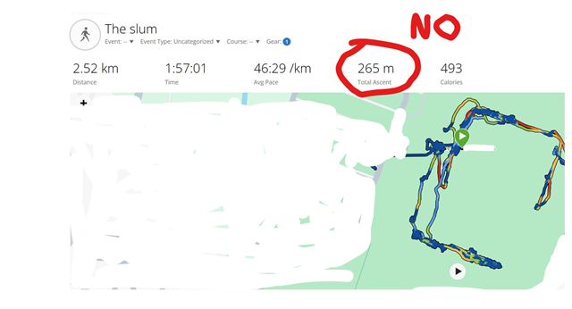

Has anyone else noticed relatively recent grossly inflated elevation gains on activities following an update, possibly some time this year?  I now see this all the time.
Examples:- 2 hours walking around a completely flat running track and rugby field on a stable pressure sunny day.  Elevation gain 265m

This is clearly barometric sensor related as if i go onto Garmin connect and change the elevation source to DEM then the 265m magically becomes a more plausible 6m, the 50m becomes 9m and 65 becomes 12.
