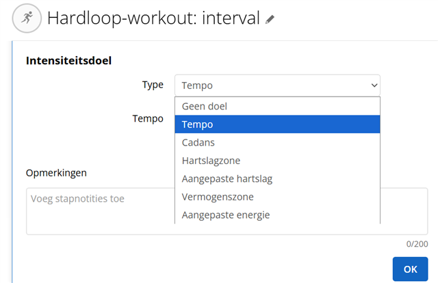

Can any of you here help me out adjusting the intensity goal for a step in a workout from tempo to speed? The screenshot underneath might help clarifying my question (sorry, in Dutch though ;-))
Cheers, Ewout
Cheers, Ewout

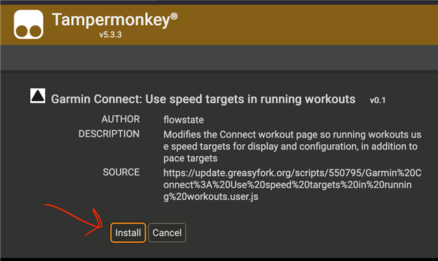

Here is a solution to use speed targets in the Connect website workout editor, for running workouts. It will not work in the app, but I see you are using the website anyway.
1) Install tampermonkey: https://www.tampermonkey.net/
2) (Chrome only) Follow the instructions in the tampermonkey FAQ under Q209: Permission to execute userscripts: https://www.tampermonkey.net/faq.php#Q209

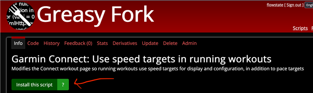

3a) Open the user script at greasyfork.org:
"Garmin Connect: Use speed targets in running workouts"
https://greasyfork.org/en/scripts/550795-garmin-connect-use-speed-targets-in-running-workouts
3b) Click "Install this script"
3c) A tampermonkey window will open with the script - click "Install"

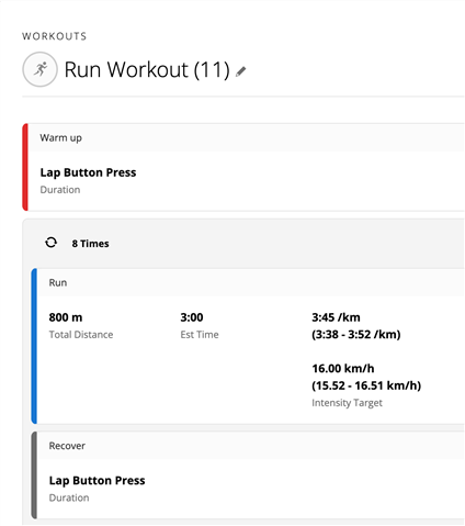

Open a workout in the Connect website and:
- you'll see speed targets in addition to the existing pace targets, in the text description of existing workouts
- when you edit a workout and select a pace target, you will also see fields for the corresponding speed range. When you update the pace range it will change the speed range, and vice versa
