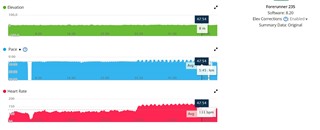

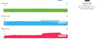

I went back into all activities (Garmin connect shows the watch + firmware used in each activity) and came to this conclusion:
firmware 10.x   11.x     :      ok      (not as accurate as chest wrap but ok)
firmware 12.x + later   :      not ok   (unexplainable values going too low / too high)
it's not the temperature (cold) ; it's not the cadence lock ; it's not the position/tightening  : ruled that out and did many tests.

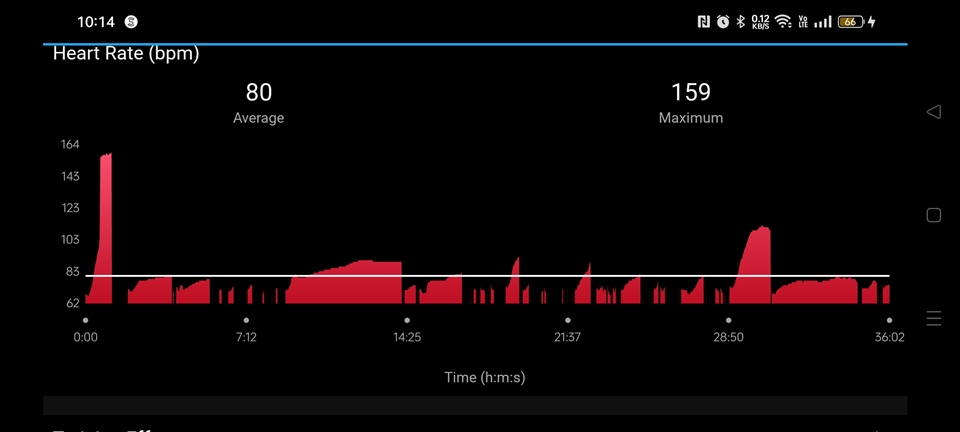

  • I totally agree. My wrist HR monitor became unusable during activities. For example, my real heart rate is 150+, and the watch shows values between 120 and 140. At times, it's even lower, and because of that, my VO2 max and training status are incorrect. That's why I started turning the monitor off before each activity. When I'm not exercising, my HR is totally fine. I compared it with the values I get from a pulse oximeter, and it's correct.

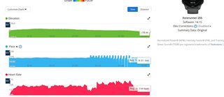

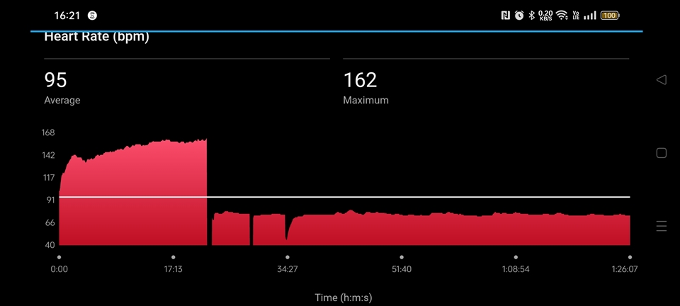

    I actually don't think the issue has been around for that long, at least I didn't encounter it. It usually picks up the heart rate in about a minute, which is totally fine. I started to worry when it spent half an hour at around 70bpm. I rode uphill, and I know my cardio stuff sucks. The actual heart rate should be over 180, and it doesn't register AT ALL. My usual bike rides stay over 170 for the majority of the time (see my screenshots), 70bpm is definitely really wrong.
    Rebooting is kinda fine, at least the progress isn't lost... but the problem is that rebooting doesn't always fix the problem, also I have to stop and wait for it to reboot so the GPS tracks are normal. (also after reboot, it goes directly to the workout screen, but pressing start doesn't work. I need to do Resume later > Workout > Resume. Latest firmware seems to have fixed it, haven't tested it.)

    I am currently using firmware 14.15, and heart rate readings seem to be pretty good for indoor running and outdoor bicycling in my activities.
