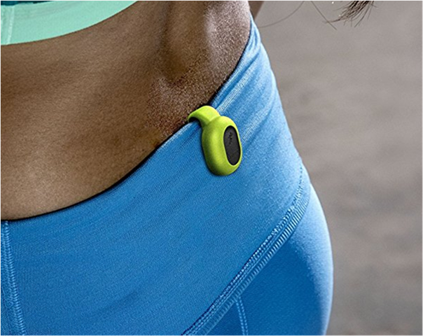

I just got a new Forerunner 255 and Run Dynamics pod for Christmas. When looking at my summary stats the Vertical Ratio appears to be missing, is there is reason for this? I am running latest firmware 13.21

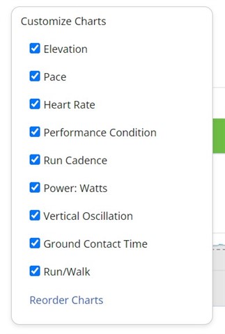

Yes, the Vert data should be there. I'd assume it is also missing from graphs? It should be above the GCT graph if presented the same way as data from the strap.
It looks like a bug to me as Vertical Ratio is simply, vertical oscillation divided by stride length. The pod is capturing all the basic metrics but Garmin Connect is not telling me what the ratio is. Cant see or find any option to present this graph either.
