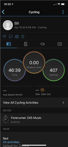

Hello Billy, did you save the activity? If so, did it upload to Garmin Connect, and can you attach a picture?
Hi. Yes, I save it and I assume the Save worked as the time came over.
