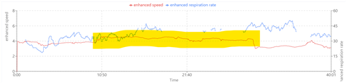

I've noticed that when I'm running at faster paces there are frequently gaps in data from my HRM-Pro Plus during or around the faster paces. Take the activity below, for example. I was running at threshold pace during the highlighted period and there were plenty of gaps in respiration rate during and even after.
I'm wearing the HRM pretty tightly and I'm wetting it before the activity. Are there any other suggestions for reducing these gaps?
  • I had same issue, reported it to Garmin and they replaced my HRM-Pro Plus.
    With new one, problem still exists but not so often like it was earlier.
  • When I chatted with them about it yesterday they basically just told me good luck and sent me a link to an HRM troubleshooting page. I guess it could be worth trying again!

  •  a lot are experience this(my local run club), I think there are underlying design issues on the hrm pro plus.  Rumor is a new version is coming out later this year. (  amazon did a major sale and cleared all their garmin hrm pro  plus ! )
    Btw, whenever you lose respiration rate data, your heart rate will also be inaccurate.  either spike up some beats or down some beats ( 5-15 bpm range )
    in our testings, connect with BT will provides a more stable connection than ANT+ , you may want to give that a try.  ( you do lose ground contact ratio data L/R)
  • I'm using ECG gel and it helps but not always.
    Interesting is that respiration data lose was more often when temperature outside was below 10 degrees.
    Another interesting thing I'm observing now is lack of respiration data not at the beginning but closer to end of run when I'm definitely completely sweat.
    And yes, lack of respiration data usually is combined with inaccurate hear rate.
  • I tried ecg gel before and really didn't help much. Inconsistent result like you said.  But going Bluetooth mode does seem to be more stable than ant+.
