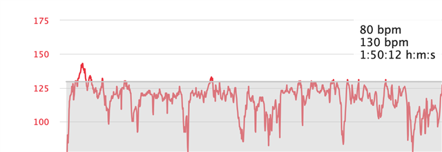

  • Yup, your chart is right on. HR increases up relatively quickly then eventually settles down. For others that have commented about wetting the leads are not quite understanding the issue. It’s not a connectivity issue. The HR monitor works fine in warmer temps but as soon as you step outside when it’s cold it acts up. I’ve been running with my older HRM TRI for a couple of months now and I have had zero issues. Including runs in the teens. The other morning it was 15 degrees and had I had no problems with HRM TRI.
  • here is my example. This was an easy run. Notice the same spike in the beginning.
  • Yeah still same issue I have to switch to wrist based HR. You can see the spike… then you can see after I disconnect the hrm pro.
