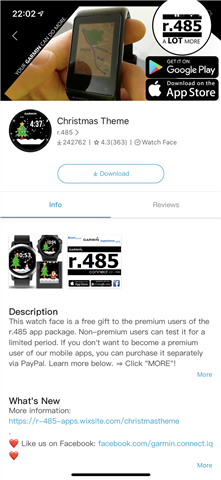

  • I had problems with the battery draining. However I foun the problem was a watch face that I had installed but then changed back to my usual without uninstalling it. I’ve since uninstalled the watch face and deleted it and touch wood battery life has been back to normal.
  • Former Member
    0 Former Member in reply to sarahdraperuk
    What watch face was it?
  • Former Member
    Thank you. That's not one I have but good to know.
