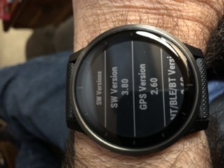

    Just bought VA4 and it does not stop blinking. This is my first garmin watch. Is it a software problem, that will get eventually fixed or hardware? I need to know to decide to return it or not..
  • Should be software, because the watch had that bug, fixed with one release and recycled with 3.8.
  • +1. Same problem here with the new v3.80 firmware.
