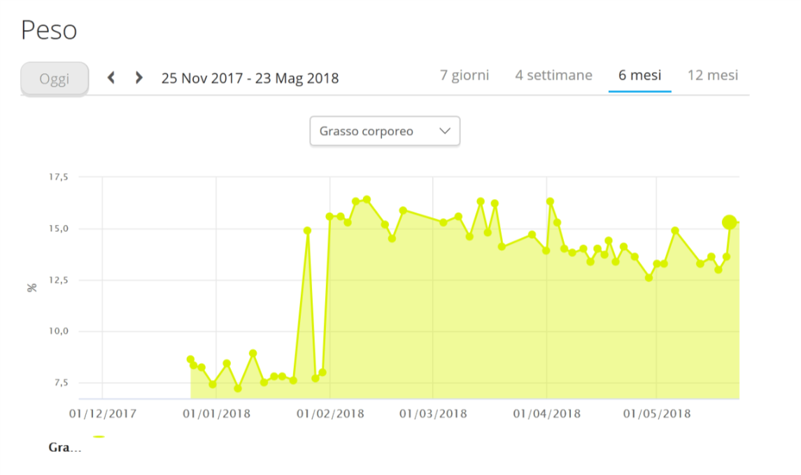

    This isn't true. I'm at activity 8 or 9 (switch between 2) and I register at 14.3% BF. I don't think OP's problem has anything to do with that.
    And for reference, this is a picture of how 14.3% BF looks like for this Garmin scale.
    https://www.facebook.com/photo.php?fbid=1735818713298149&l=355a6fcf93
