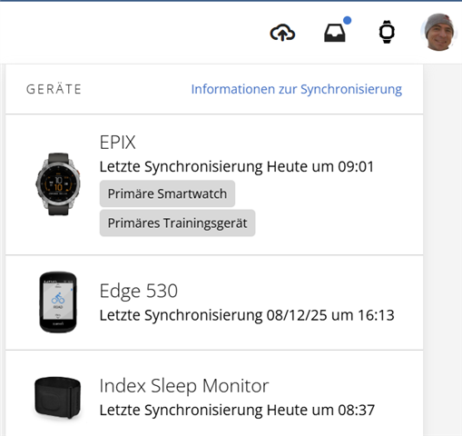

    Meanwhile I can't adjust the "primary device" any more. I see that my Epix is the primary device, but I can't change it. See screenshot.
    The screenshot also shows, that the Index WAS synced this morning, however I get no sleep data.
