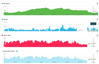

    Checking the file, I can see that the HR is connected during the pause, it disconnected when I resumed the activity!  From the attachment Connect screenshot you can see where speed dropped to zero and elevation is constant, HR and respiration carry on until I hit resume, when speed changes, elevation decreases and HR cuts out.
    I am not 100% sure on the button presses, so I'll try and replicate it and see what happens.
