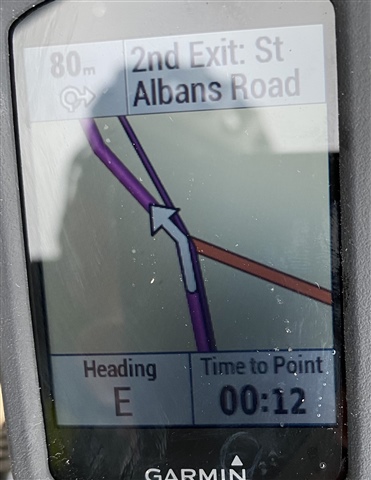

    I got some lovely clear TBT instructions at junctions and a perfect level of zoom, with a whole arrow and also the next arrow if appropriate, including this at a roundabout

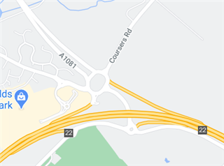

    However on both routes i got a new bug. The TBT didn't start until a few turns in. So on my second route i didn't get instructions for the first or second roundabout or the third turn (pictured below), it just showed instructions for the later left hand turn and an accurate distance. The triangle on the map seemed to be accurate and the route line was also there (it shows i need to turn right and gives the street name), so i could see my way on map view:
    And then when i came back to the roundabout it was kinda zoomed in, but not bad enough to be unclear:
    MB
  • That first pick looks Ok hand tone5, amazing. Just what you'd expect to see. I am getting something similar at about 50% of the junctions on my routes.
    However, the second one is what I then experience for others. It sure is odd why it treats some roundabouts different to others!

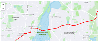

    However, i am getting it when the unit is displaying a straight on arrow in the middle and a turn message in the top banner. I know it's super zoom as i only see the blue triangle very briefly / quickly. I'm not sure why i'm getting this "go straight on whilst turning" message but the course line is clearly showing straight so i can ignore it. I suspect that it is the unit trying to get me to ride on a cycle lane. Could this be possible ? The lane is only 1 or 2 meters to my left, so that might be why i need to turn onto it but the main arrow is straight ?
    This is the course: https://www.strava.com/routes/2754041889467281850 and below is the section i had this a lot. At the roundabout over the A406 / North Circular (top right) it didn't show the full roundabout because it was trying to get me to go on a cycle lane over the damn thing.
    Can i tell the unit to ignore cycle lanes / tracks ?
    MB
  • I have the go straight on with a turn arrow at times as well.  It should be obvious if it is trying to get you on a cycle path as it will say cycle path or something like that.  I have the issue when there is no cycle path.  Usually I see it at a side road and the arrow with the name of the side road with the white arrow pointing straight on.  I have seen it with no side turning as well though.
