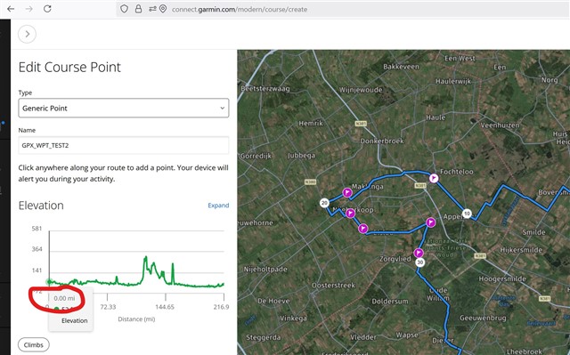

  • I see the issue. For some reason the early course points have a distance of zero so will not show. looks like something went wrong in the creation process

  • I have opened a ticket with Garmin on this. The course points may show on the Edge if you are not on the course, but once you are on the course all those with a distance of zero would be treated as though you had already past them and hence would not show.
    The issues is somewhere in Garmin Connect with the course creation.

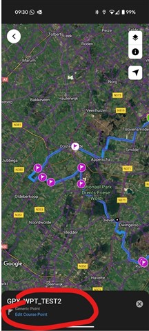

  • I don't use GC much for course creation, is there a list or table of course points that can be viewed in GC or just the individual points on the map (or download / view the Fit file?)
    Previously this "zero distance" issue has cropped up where people import or download the course in GPX format and GC creates "Waypoints" with 0 distance which then get transposed into Locations on the Edge.
    Ronald, you didn't import a GPX with "waypoints" and edit from there?

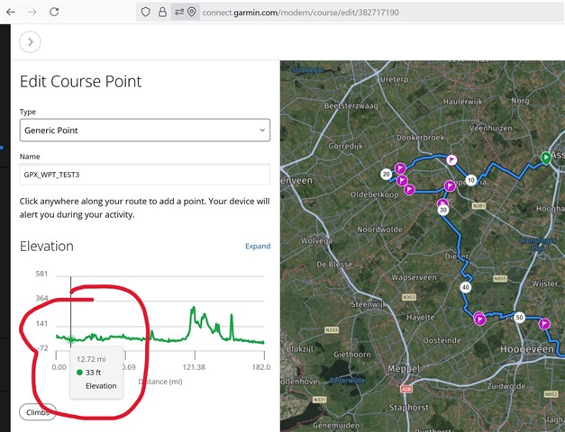

  • I think it’s going to end in the same origins as my issue… that unless the course points are on exact vertices of the route, so that there are common coordinates in the GPS course points section AND the track section then they will display as zero when starting the course.  They preview OK in Garmin Connect but not when course started on device. Because you can’t start course until at the start it’s hard to preview the issue without downloading and viewing in table as  did above

  • Cn you share the GPX with waypointsembedded, then it’s possible to check the wpt/course points are coincident as try/track course vertices.  The possible bug is GArmin Connect needs to improve the user experience to either show points in different colours (so they can be fixed) if they do not lie exactly on the course or snap or create new vertices… anything such that the user gets to see the waypoints on device when actually out on the course/event
