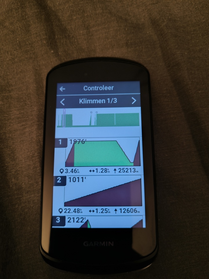

Since a couple of months after an update my device is detecting climbs which is not even a bump on the road. Currently on 27.12
It's always the same segment i ride it detects and climb pro will say "climb".

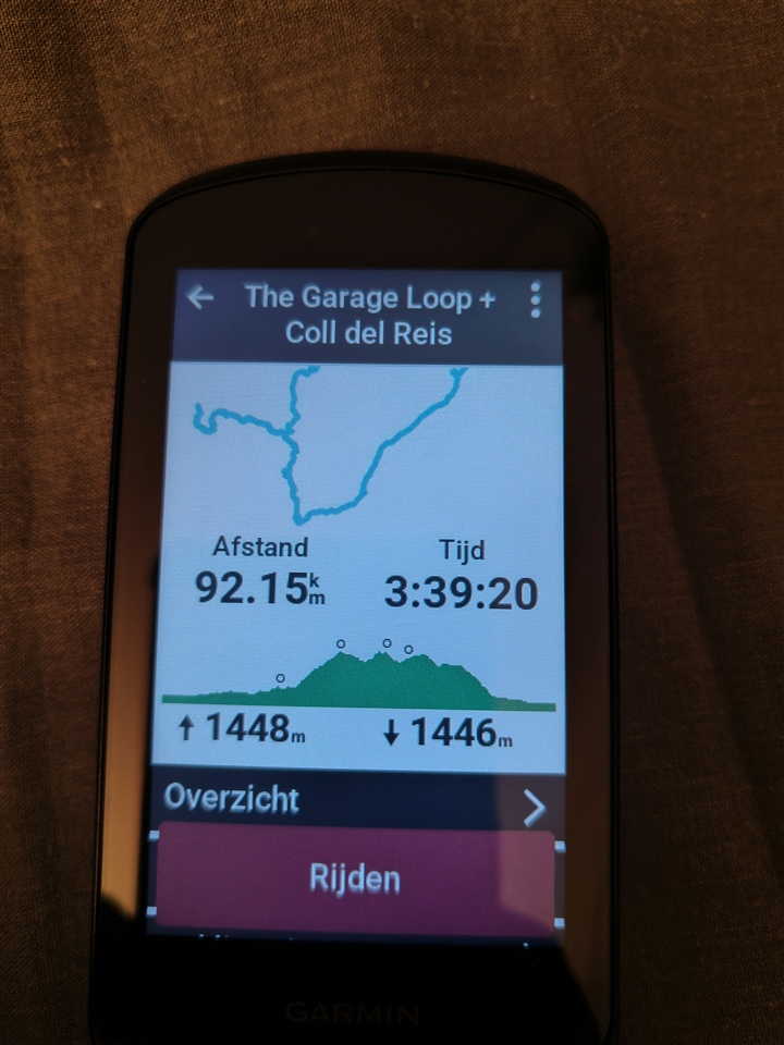

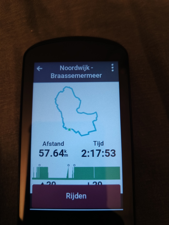

Attaches i have loaded 2 route. The garage loop is where there actually are climbs on the route and the other is just a flat route. As you can see the elevation graph and the climbs on the course is all weird.
Has anyone has this issue and was able to solve it?

    have the same issue here in NL but thought it was a corrupted map db but now realize it’s the direct Komoot to 1040 sync most likely.

  • I started the post on the beta forums and there are some workarounds, but of course I would prefer this would be fixed by Garmin. One workaround is to download the gpx from Komoot (or any other platform) and upload it directly to Garmin Connect. Then it will appear with a correct elevation profile on your Edge. Another workaround is to duplicate the route in Garmin Connect.
  • Note that the issue in your post on the beta forum is something different than the elevation issue being discussed here.
    The elevation issue is that during the sync of a route from Komoot (and other platforms?) to Connect (which happens behind the scenes), the elevation data in the resoluting course in Connect becomes messed up (looks like an integer overflow to me).

  • Not only kamoot and Strava, I've been seeing the same issue with routes created in ride with GPS. Both in the femlands of UK (cambs, lincs) and around port pollenca Mallorca, and occurs when the elevation is down around (or presumably below) sea level.
    What's interesting is it's doing it with old routes that a year ago didn't cause this problem, so clearly a regression on Garmin's part. I would do the GPX export/import but it generally looses custom cues (not to mention is a lot less convenient) so instead I'll just live with these impossibly high climb hallucinations for now.
