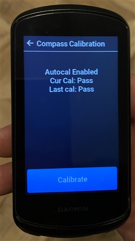

  • Have you calibrated the electronic compass ?
  • I used 1030plus in the past, and I calibrated the compass, but it didn't improve
    1040 I don’t know how to correct the compass, I don’t think there should be any improvement
