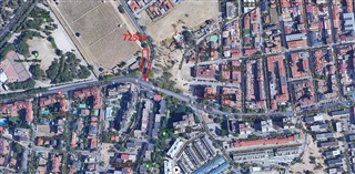

  • I think this topomap data is not accurate, the accurate altitude data is at that point is 694-695m (not 701m for sure, maybe it is a very old survey data with inaccurate devices), i dont have time to find a fresh LiDAR based topo data for that exact place but if i will have time, i will search..
    i think You spend too much time with this unnecessary :)
    meanwhile i found a more accurate datapoint near to this ( i think You know this place good from a sat pic), here, it is 725m (or 726m on an older map) from a Lidar based source, try to calibrate to this point and test with it if You have so many free time :)
