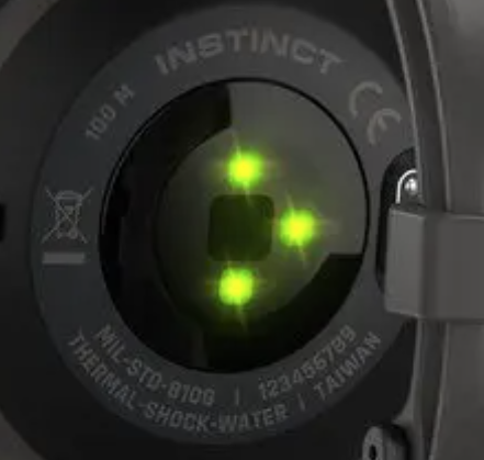

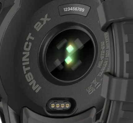

The heart rate sensor is not the same! The Instinct 2x has a flat, glass sensor. The 3x version has a plastic, convex sensor like the instinct 2 version.
If that's not the case, please correct me.

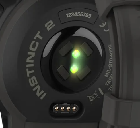

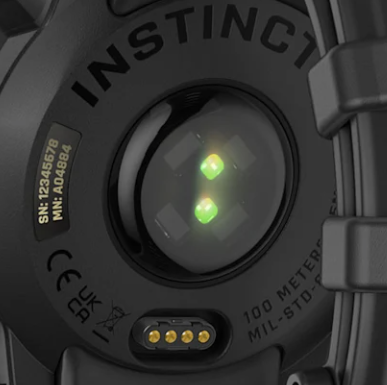

Instinct 2X has the same sensor as the standard edition of Instinct 2, it just has a ring frame around it (perhaps with a glass over the sensor, but I cannot confirm it, since I do not have it). And all versions of Instinct 3 have the same sensor too (without the frame, and without glass). It is the Elevate 4 generation.
From left to right - Instinct 2, Instinct 2X, and Instinct 3:

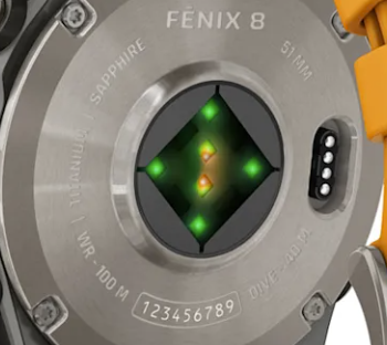

Elevate 5 looks like this (on Fenix 8):
And Elevate 3 on the old Instinct (1st gen) is also different:
The Instinct 2x has a glass straight sensor. Instinct 3 has a plastic sensor, rounded.
Yes, the sensor cover is different, but the underlying sensor itself, in both watches, is the exact same Elevate 4 sensor.
