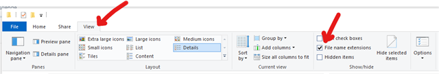

I’ve been trying to calibrate the buttons and have not have much luck with having the key calibration file work on my Fenix 8 as per the instructions in previous threads. I’m on Mac and after creating the file inside the watch through connecting it to my computer, and disconnecting it, no key calibration popup occurs prompting me to press the buttons.
