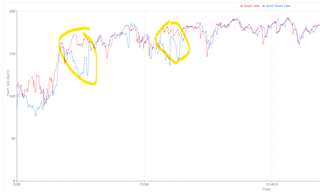

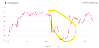

Something is really off with the wrist heart rate - I compared my HRM pro plus and the wrist readings from yesterday's workout:
I added the yellow markings where it really seems that the software does some corrections - for a good reason in the first case, for no reason in the second case. After about 10 minutes it's fine (close to the HRM) - why not in the beginning?
Garmin-Laurie, are the software engineers aware of these wrong wrist heart rates?

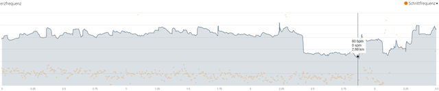

For a walk, there was a 4 minute gap yesterday, which seems similar to everything bad I've known for walks for quite a while now:
It was just yesterday that in the middle of a walking activity there was a phase of pulse in the sixties, which I only have when sitting or laying - not during a walk:
This doesn't happen in every walking activity but quite often - so it is totally unreliable.

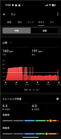

私もアクティビティ中に写真の様に運動強度を変えていないのに心拍がおかしくなりました。その後は追い込んでも以前のように心拍は140前後以上にならなくなっています。今が正しいのかもやもやしてます。
