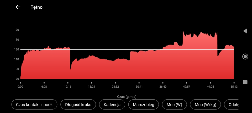

As far as I understand this bug (I have it too on Fenix 7s SS) - firmware goes nuts when HR changes rapidly, like during interval training. I assume, Garmin tried to implement some kind of heuristic algorithm…

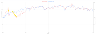

Something is really off with the wrist heart rate - I compared my HRM pro plus and the wrist readings from yesterday's workout:
I added the yellow markings where it really seems that the software does some corrections - for a good reason in the first case, for no reason in the second case. After about 10 minutes it's fine (close to the HRM) - why not in the beginning?
Garmin-Laurie, are the software engineers aware of these wrong wrist heart rates?

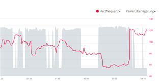

I can confirm this as for my testing scenario with two units one on 15.77 and one on 21.19 which I described in more detail here:
As soon as heart rate is changing rapidly OHR readings go nuts to both sides and easily as much as 35bpm both sides. It takes some time (minutes) for the system on 21.19 to synchronize if the change was really rapid. This was not the case with the testing system on 15.77 and still is not the case on the everyday system with 15.77. Both units are used simultaneously, both with nylon loop straps which guarantee imho the best fit and thus the most reliable results.
When I'm done with the testing I'll post a summary. So far it doesn't look good for 21.19. Of course I factory reset the test unit after update for good measure.
