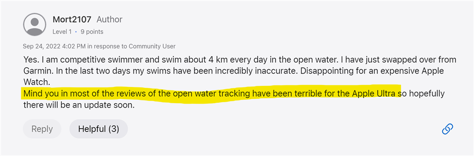

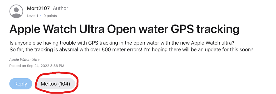

  • I finally got so fed up with any lack of ownership and response from Garmin, I just bought the Ultra.
    The results over my 2300m course are that the Ultra reports 100m less than the 735 (which I always knew was over-reporting) and 200m more than the Fenix 7, which I knew was massively under-reporting and the reason I am on this forum. I actually believe the report of the ultra, which ironically coincides with my friend's Swim2
    Also the Ultra provides much more accurate tracking of laps in a pool - it was spot on this morning, whereas the Fenix rarely managed to record 1000m, sometimes giving as low as 400m.
     So I am going to stick with the Ultra.

  • I am not surprised that you changed brand. Having multi sport watch that has such serious open water issues from the January and there is no involvement and solution a year after problem was reported by many users, clearly indicates that Garmin support and watches are severely lacking functionality in some areas although it is marketed as capable in those areas.
    I am glad competition is better that Garmin in some areas. Sentence about philipshambrook was hilarious Slight smile
