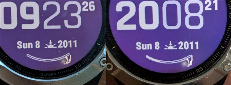

I've had my Fenix 6 for quite a while now (3,5 years approx.) and for the past year or so it started slowly developing a patch of dead pixels in the bottom right of the screen. No warranty anymore unfortunately, so I'm just ignoring them. However, recently a spot started developing behind those pixels and this one worries me a bit since it looks like a heat spot. It is not a reflection from a light ;) The spot even seems to completely remove a few dead pixels, as the patch was larger than it is now.

    The spot could be a "mura spot" (LCD defect that develops over time), however with the patch of defective pixels nearby it suggests a common factor, but what? Mechanical (swollen battery, lose item due to a drop) or thermal (defective battery or component). Or just two unrelated issues. Does the watch get hot while charging?

    The watch does have a rattle when it vibrates for alerts (it's more noise than it should make, but I never investigated what it was), but that's been going on for 2 years or so. I doubt that would manifest itself as an issue just now. It doesn't get hot while charging, luckily. I also checked the schematics if it could be the battery, that was my first guess, but it looks like the battery occupies the better part of the whole watch. So if that swells, I doubt it would cause issues near the edge of the screen where my issue concentrates.
    It also seems that the pixels / spot grow / change in a short time, this is a comparison over the last 12 hours:

    Unfortunately it looks like the LCD is going bad. Maybe if you call Garmin product support, thetly have an option for paid replacement if you cab agree with the price. Or just wait it out, maybe it just stops.

  • It looks like the battery is good for now, and the dead pixels are gone. Though I am not sure if the pixel revival is related to the battery replacement, or just something that happend during (disassembly).
