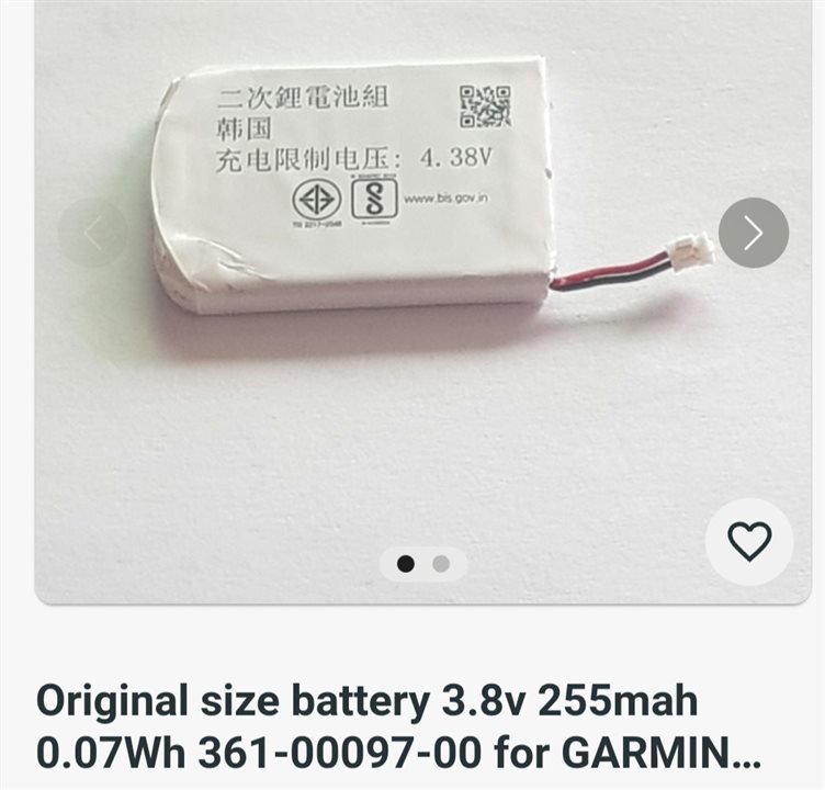

  • NOPE !!! Never !!!! False Advice !!
    1)
    F6 Sapphire
    You are linking to a battery that is ADVERTISEDLY  for a 6X. This was not asked for.
    Physically, a 6x battery is the wrong size and does not fit into a 6
    2)
    This is another one of those websites offering false products. The battery offered there is NOT even suitable for the watch specified threre!
    It is a 3.7V battery. Wrong voltage !
    If you install this battery, you run the risk of losing your device due to a LiIon fire. And possibly even more than the watch will burn down as a result. If you are not familiar with these batteries, you should keep your hands off them. DANGER !
