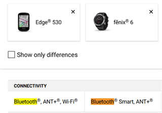

For the past month or so Connect has been forgetting my paired Fenix 6 Pro Watch, what is bizarre is that Garmin Connect NEVER forgets my paired Garmin Edge 530 bike computer.

    BTW, which phone brand do you use? Isn't is by hazard Pixel, or Samsung Galaxy S2* ? Those are indeed known for forgetting already paired BLE devices. Often the interference between the Wi-Fi and BT (using the same 2.4 GHz band) causes problems. In such case, changing the Wi-Fi to the 5GHz band may help (assuming your phone and the Wi-Fi access point support it)
