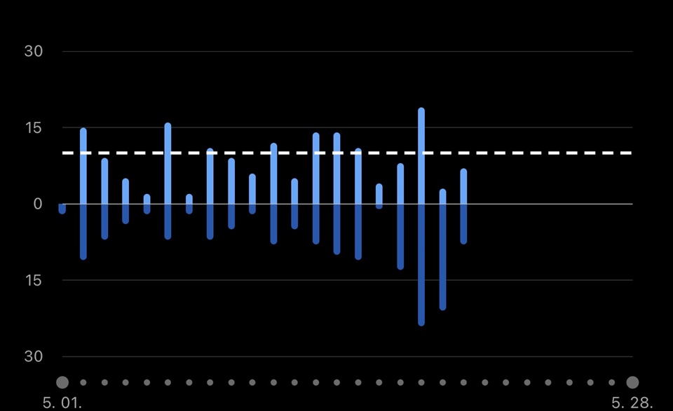

After SW update (on the same day or two days later, I don’t remember exactly… sorry!) the floor counting, body temperute measuring and sometimes(?!?) the altitude measuring is failed! No data of these since 21.05.2024!

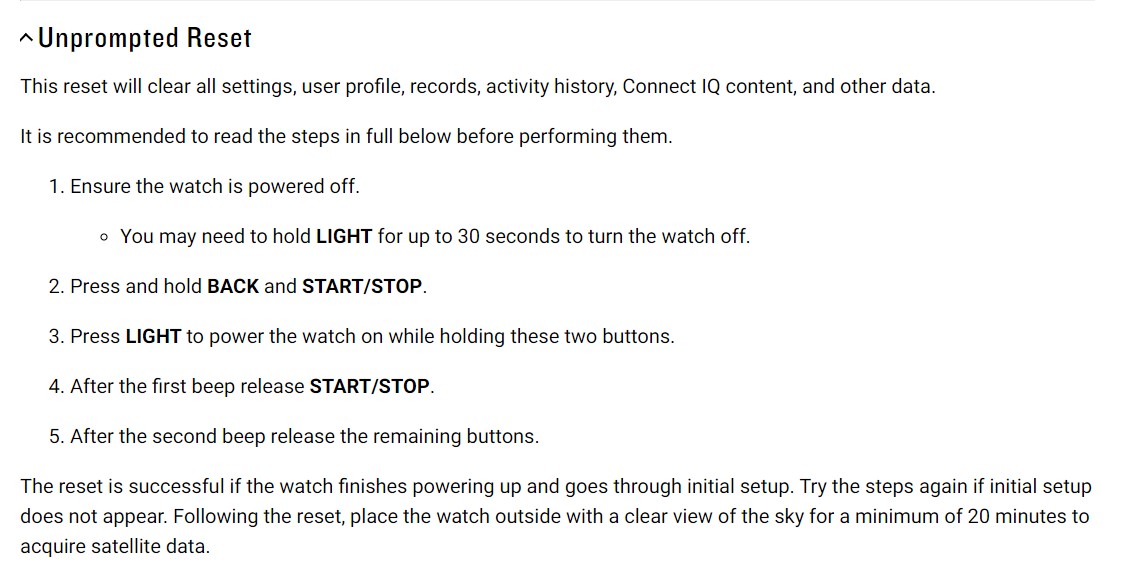

    • If this issue continues, I would recommend completing a factory reset with these steps:
