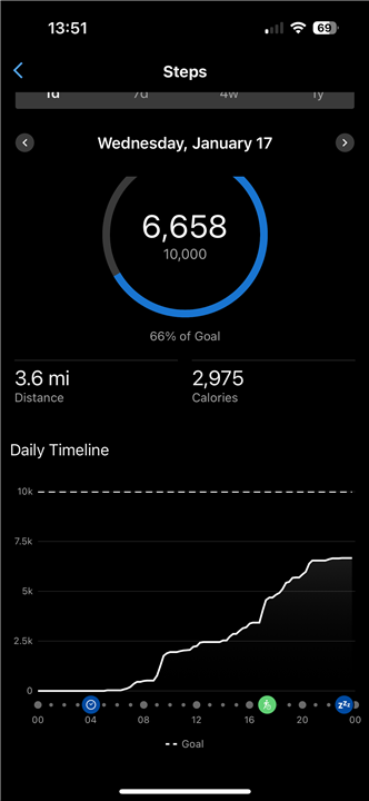

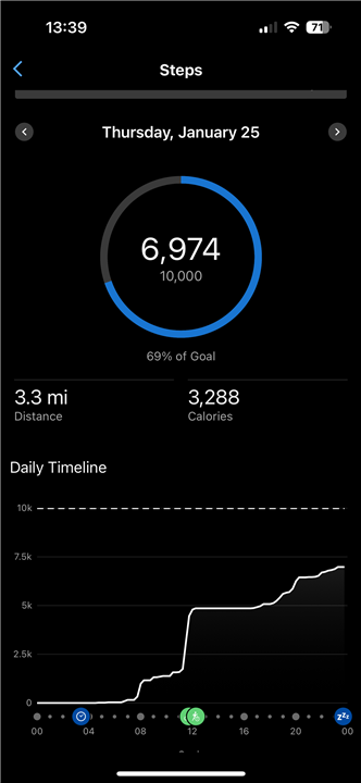

This issue started happening just 4 days ago. Recently my cycling (done on Zwift and this connects to power meter, HRM pro, zwift) and strength training which I do afterwards have been sky rocketing my step count. This is so strange because when I look at the history of my step count, doing these two exact workouts, my step count DID NOT increase. So what has changed in the past 4 days??
I have attached a photo of January 25th showing step count and the workouts down. As well as a photo of my of today (January 31st) which has done the same two workouts but step count sky rockets.
  • Sorry January 25th did the same thing.
    January 17th was normal
  • Another thing to note.
    1. For the zwift, I do the workout through zwift and it automatically uploads my ride to Garmin
    2. Strength workout, I wear my watch and select Strength as the workout. So this is coming straight from my watch
    Confusing thing is, it seems like my watch has gone back and recalculated some workouts as walks since I was looking at the history of step count. I know for a fact my step count would hit 8K-10K after I would walk close to 4-5 miles. So whatever recalculation this is doing to get my step count I want this turned off right away because this was not a thing before. This is something I just noticed as of 4 days ago and know it wasn’t a thing a week ago.
  • Steps are beg detected by the accelerometer in the watch or byt the accelerometer of the HRM-Pro strap (only when the watch is not worn). And that happens all day long regardless whether you record an activity or not, with the exception of a few activity types being recorded on the watch (not through Zwift, though !!!). Cycling swimming, kayaking, and few other activity types suppress the steps detection (the full list can be found in the article Why am I Not Gaining Steps During Certain Activities | Garmin Customer Support, though the list is not accurate for every watch model)
    It means that when you ride your indoor bike, the watch (or the strap) detects some vibrations that it interprets as steps. To avoid it, you either have to remove the watch, and stop the direct connection of the HRM-Pro to Garmin Connect, or you have to keep the watch on, and start a Cycling activity on it (you can discard it at the end).
