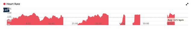

While cycling I broadcast heart rate from my Fenix 6X Pro to my Edge 1040.  On my last two rides the Edge would randomly stop displaying the value despite the watch typically still showing that it was broadcasting.  Sometimes I can fix it by waiting a little bit and then restarting the broadcast, but most of the time I end up having to restart the watch, wait for heart rate to be measured, then start broadcasting again... then keep an eye on it until it fails again.
I suspect the cause is the Fenix rather than the Edge since sometimes when trying to start broadcasting it will switch to the "Stop" view for an instant before moving back to showing "Start".  I'm not sure why the watch would fail to broadcast so quickly?  Also, power/cadence sensors on the Edge have never had this issue.
This has definitely happened in the past but was rare enough to not cause too many problems, but for it to do it twice in a row is concerning.
I've attached screenshots of the last two rides.  You can see there does not appear to be any pattern in why/when it drops off.

    I would not rule out the edge as source of the drops
    looking at the provided hr graph
    • there are the high ridges when starting to log after loss (edge suspect)
    • the low ridges picking up hr around 70bpm (fenix suspect)
  • Anytime I restarted the watch it would always be slow to return to the expected value.  I'd see it at 70-90 before making it's way up to 130-150.  If I waited longer before restarting the broadcast or was able to broadcast without rebooting the watch, the "correct" value would be stored.
