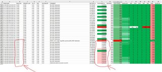

Just noticed that my battery consumption is roughly doubled after the 24.10 version was pushed to my Fenix 6X Pro Solar. With 24.00 my average battery usage was ~0.2 % per hour and now with 24.10 its ~0.38% per hour. I'm currently charging the watch so I will restart it after it have been fully charged. Then look if the problem persists or not.
See screenshot
  • Its a simple tool which I have built myself. It grabs and process the information in the Debug\usage_hrly.log file.
  • so i need to connect watch to pc via cable to check directory?
  • Yes, exactly. And you probably need to be a member of the beta program to enable the hourly logging. Or, install secure_config.gcd according to the beta information. Information is found here:
    https://forums.garmin.com/beta-program/fenix-6-series/f/announcement/314858/beta-version-23-84
