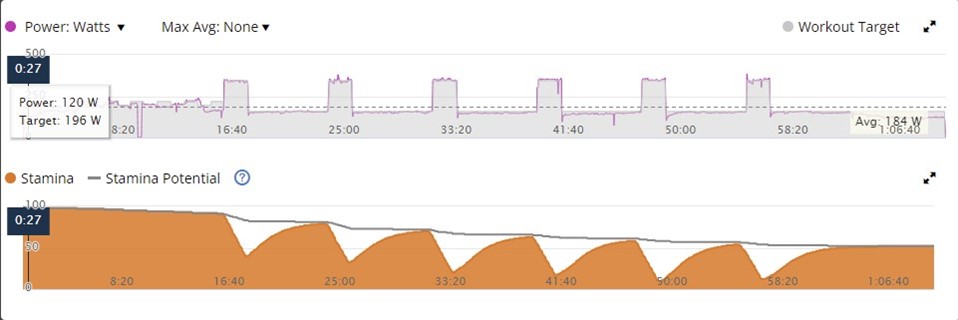

Here is a biking example Anaerobic - Aerobic 3.7 - Anaerobic 3.2
Intervals were 90s, 6mn rest at 150% of FTP
