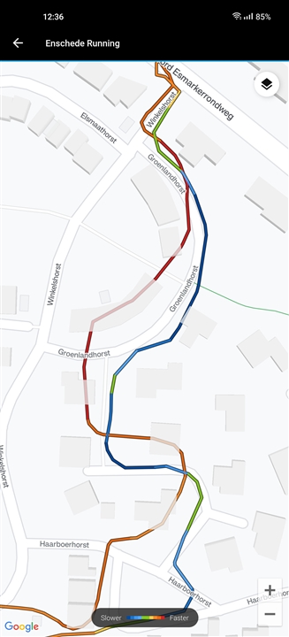

  • It would be really great if this drunken hangover gps track would get its *** together and stop running around in ransoms people's gardens (which I obviously didn't do)
    Try deleting the CPE file in the folder //GARMIN/REMOTESW/ and then checking for updates and syncing over the USB cable with Garmin Express. Sometimes a corrupted CPE (ephemeris) file may cause such problems, despite that the watch reports the "current" status at CPE. Do it shortly before you go out, to have a fresh ephemeris data. Using Garmin Express is preferable to Garmin Connect - GC works too, but there is a higher chance of the update failure, or data corruption.
    Also do a soft-reset of your watch (hold the Light button for ~20s till the shut down) - especially after firmware updates, issues with GPS are rather common, but the soft-reset helps to get it back working right.
