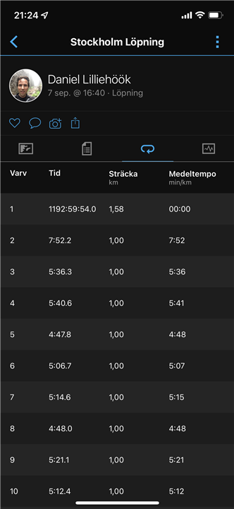

Screwed up data first km in v23.00?
This happened several activities in a row now. Directly after start, my Fenix 6x autolaps for 1 km after 1 second. The time shows up absurd in the log. After 1km of actual running, the watch blips for auto lap 2 km with a km-time that is longer than I have been out. Something seems very screwed up here, right? Anybody else having similar problems?

  • Similar type of thing here. Garmin recorded the first lap as 10:00mins (correct) distance was 12650 metres!! Av pace 0:47min/Km. Even Kipchoge won’t manage that!
    I’ve done a few runs on v23.00 with everything ok. Had a decent amount of gps green time before the start. I was however using a structured workout that does the laps for me. This discrepancy was in the first lap of 10mins warm up but was as you described.
