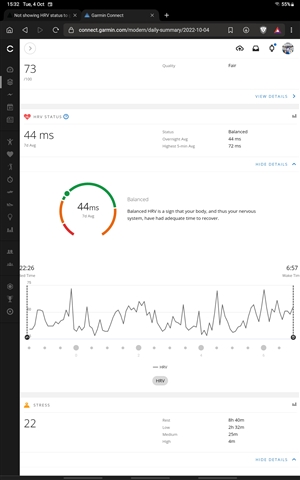

where do you see the HRV status on the web? I don't have anything in Reports - HRV Stress (I would probably have to do a chest belt test)
HRV Status is not the same as HRV Stress. You can see HRV Status in your Daily Summary, assuming there is data to display.
