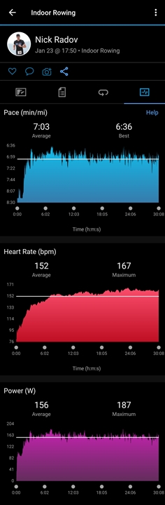

Here is an activity that I recorded on my watch showing a good power chart.
