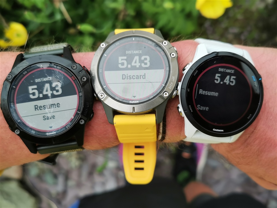

  • I have a Polar V800 (once, arguably, the gold standard for GPS accuracy in a watch), fenix 3HR, fenix 5X+ and fenix 6X Pro Solar.
    I have performed numerous side by side comparisons, although not in the last 12 months, and in my opinion the 6X Pro Solar creates the most consistently accurate tracks in general use with GPS + GLONASS enabled. The V800 generally performs better in woodland, but overall I'd give the win to the 6X.
    Regarding distance, they all vary a little, no certain winner, but not enough for me to reject any of them. However, when it comes to running I use Stryd for distance and pace, so it's a bit academic to me.
    Regarding pace, Stryd FTW.
    People do seem to have varying degrees of success with GPS performance - it might come down to the exact model (size and antenna design), geography involved or simply expectations. I think mine is good enough that I don't need to replace it with an Epix 2 Sapphire. I'd say you've got yourself a bargain there. But test it and return it if you're not happy. Only you can be the judge for your watch.
    p.s. When I say "most consistently accurate" the watch does exhibit a track offset to the left when worn on the left wrist, typically 1-2m, but it has the least random deviations and wobbles.
