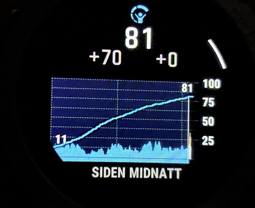

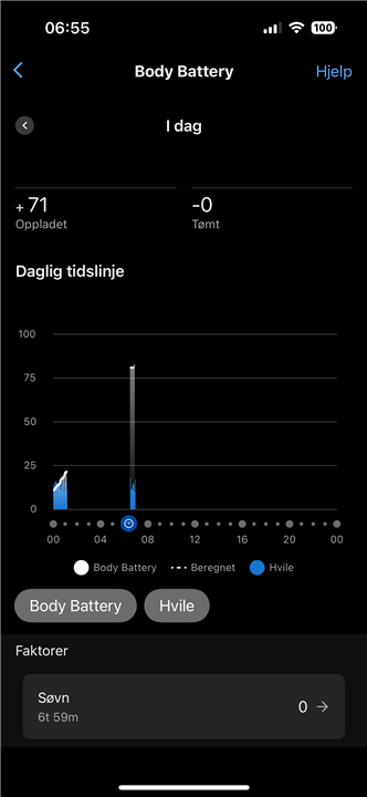

When I synced my watches via Garmin Connect this morning (26th February 2022), I noticed that HR, Stress, Body Battery & Respiration rate for part of the night is missing in the Garmin Connect app (and same applies for the Garmin Connect Web) while I can see the data in the appropriate widgets on the watch directly (e.g. for the HR, in the morning, I was able to see the graph for the last 4 hours so I know for sure, watches recorded all the HR information, similarly for the body battery I can see in the widget on the watch how BB was being charged over the night).
The interesting thing is that all this data from the night are missing exactly since the midnight - I went to sleep at around 10pm and woke up around 7am. All the HR, stress, etc. data in the Garmin Connect are available until the midnight, but then since the midnight, all of them are missing till the morning sync I initiated manually in the Garmin Connect app shortly after waking up.

  • I just experienced the same! Seems like the current value is synced and appears in the app, but not the history since yesterday night at 21:12. Tried to restart the watch without effect. Removed from app and added again, still no data. Strange.
