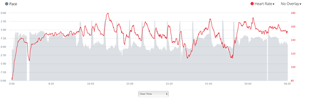

    Well to be clear I was not speaking about the reaction delay. More about the fact that with the watch some sprints HR isn't detected or it is detected totaly wrong. I would expect that during a walking between sprint HR goes to "real" value because there are less impacts that during sprint. etc. Also it is impossible from me to have 130BPM after 6th all out burst sprint. I'm not a robot :)
    So you are saying with chest strap i can/will have similar inconsistent results ( like here between 11th and 13th sprint) ? BPM going all down even though i did a sprint in between?
    As i said i don't need to have super precision. But the minimum i would expect is to at least have the correlation between speed/hr even if it is delayed. but going all way strait down from 170 BPM to 115BPM even though i did a sprint isn't very good IMHO.

  • Would be interesting to see a graph with target pace vs watch pace. Probably you see delays there.
  • Yes i was doing that before now i'm only slowly ramping up on t-5 so that at the start i can instantly go to full speed.
  • I did setup a custom Interval workout on the watch in the run app for this graph because watch suggested 7 sprints and I wanted to do 10 because at midnight before going to bed the suggestion was 10. And it reduced it to 7 probably because of "bad sleep".  So i don't have a workout target graphs for pace because target was 10s time.
    But you can see a full here ( I use you datafield since few days as well)  :
    connect.garmin.com/.../8015328779
