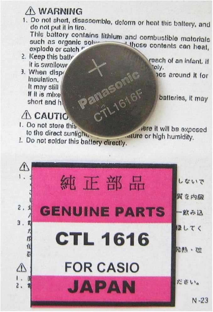

Now Casio (for example) has been proposed solar tech on their G-Shock watches since 1998 with their Raysman.
Is Solar charging bad for the battery ?
I have bought my Raysman in 1998 and it still going strong on its first battery. So it is 23 years old on the same battery using the sun light daily.
From my own experience solar charging is not bad for the battery of this old watch.
Picture from the 5th of November (remember, remember the 5th of November!), my Raysman on the left posing with my new B5000TB)
There are alternatives too charging the battery, you could also charge a capacitor.
Yes KrapfenKringel, of course. Solar Panels Juice can go their own way to the "engine" of the watch.
Casio got "button rechargeable batteries" and Fenix seems to have "Capacitors".
No need to play with words. You could charge "anything" and the question was about "battery" in regard of way they can react to "over charge" (the law of 80% max to keep them in good health)... ;-)
Yes that was the question and you talk about some old Casios that do this for years (I my still own a 15 year old Casio solar that says its power source is fine). But I suspect they didn't have the batter technology of today and used capacitors, anyway I'm not sure.
But as stated in other posts it also seems its not a problem for modern batteries (Just those old Casio's might not be a good example for that).
