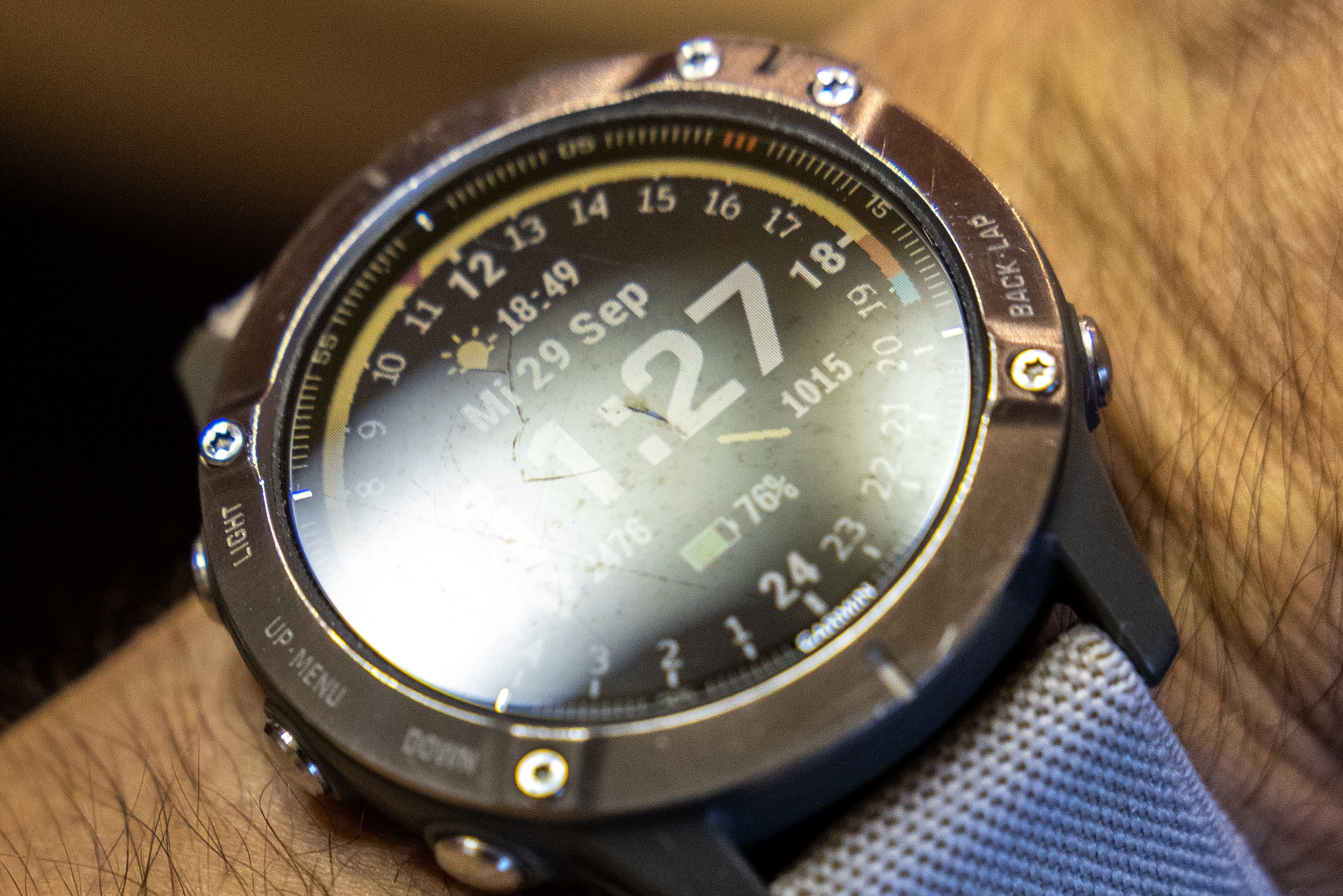

  • Do you know how I can remove the Saphire coating? Do I need special tools and be careful not to damage the bezel? Mine looks really bad.
  • Do you have a picture? It sounds like you're referring to the oleophobic coating on the sapphire crystal? If so, this will normally wear off over time although it's been known for the coating on new watches to become 'blotchy' quite quickly.
    To remove the coating you can use a very mild abrasive (e.g. toothpaste applied carefully with an electric toothbrush) or Isopropyl alcohol and a microfibre cloth.

  • In another thread, I have to search, it looks like a cheap scratched plastic display. Its impossible to sell that like that for the upcoming F7. So I want to get rid of the coating so it looks like new again.
    I will try, that's all stuff I have at home.
    That's how it looks now:

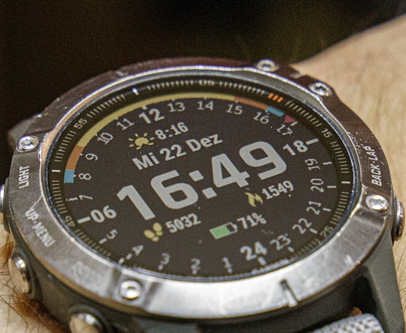

  • Wow this really worked, even the deep one in the middle, I thought might be real, is gone. Thanks.
