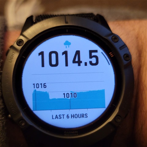

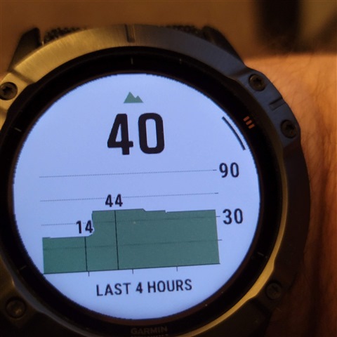

  • I think a lot of the problem is down to inability to correctly separate weather change from altitude change. For me the biggest mess has been when there have been large swings in the barometer, but the watch decides that altitude should take a hit. When the barometer is stable the altitude seems to behave itself. Today my altitude has tracked very well from 44m to 105m and back again. Since returning home it has remained stable for the past five hours, no drift. It was also good overnight, last night, from setting altitude when I went to bed, through to this morning.
    So basically it looks like the automatic determination of change due to altitude vs change due to weather is completely broken. I don't know if temperature fluctuations are also adding to the confusion, with heated homes and cars and cold outdoor air, at least in the northern hemisphere outside the tropics.
