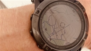

    Edit: Attached a photo of the standard map at my current location.

  •   Two examples showing a close up of a quiet area, and one of a local set of streets.
