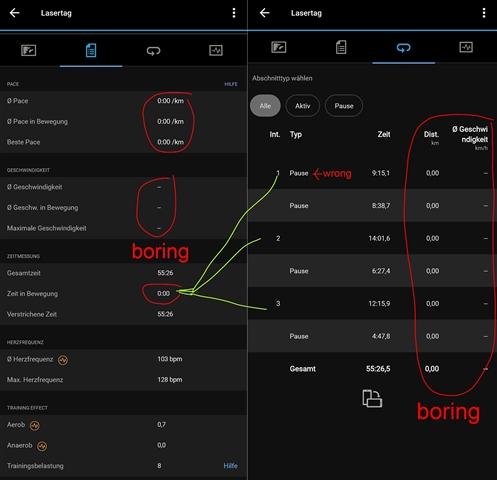

Also not that good: that activity types summary really seems to be made for outdoors activities, pace is prominent on the front page and of course is 0, Speed is not existent, time in movement is 0 even though "active time" can be viewed on the laps page. First round is listed as "pause" for some reason on the "all" screen, but shows correct on the "active" and "pause" tabs. Of course no data in distance or speed, something like average heartrate would be useful.
I disabled GPS and therefore made it an indoor activity, that should remove all GPS based data evaluations.
