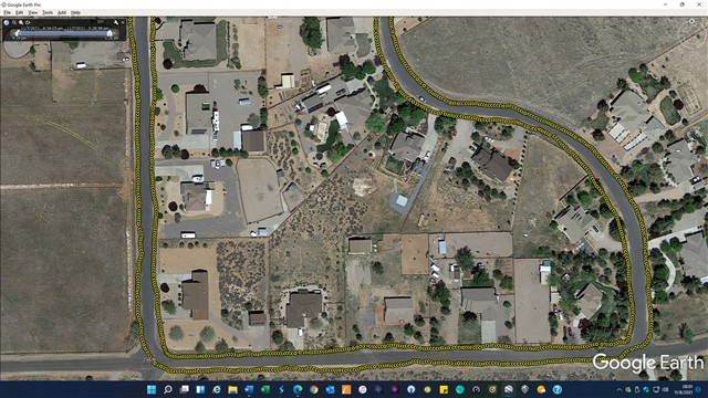

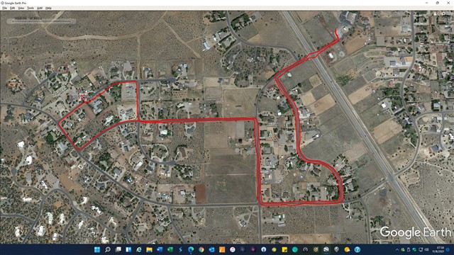

    And yet... I continually get excellent GPS tracks with my 6xPro on my (almost) daily 3-mile walk at a pace of about 18:30 min/mile.  GPS recording is set to Every Second, and GPS + GALILEO.  Auto Pause is OFF, 3D Speed and 3D Distance are also OFF.
    Here's the whole route:

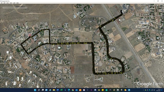

    With a yellow "doughnut" mark every time a GPS data point is recorded:
    Zoomed in so the individual data points are distinguishable:
    At 18:30 minutes/mile, and Every Second recording, that would record a data point every 4.76 feet (1.45 metres).
    So... At least at walking speed, GPS accuracy can be excellent.
    HTH

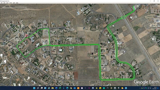

    Edit to add:
    Here's the whole route, but enhanced color for increased legibility:
    And the Hike Activity was used.
