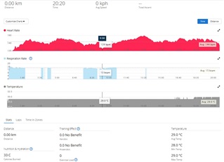

The numbers are extremely low and I can't figure out why, whether it is a setting I need to change or something else going wrong. During the last week I have done different strength, elliptical and indoor bike workouts ranging from 20-50 min, and the calorie burn per activity has ranged from 33 calories up to a max of 77, so almost next to nothing.
The first time this happened was for a strength workout, so I assumed it was because of the inconsistent HR readings that occur when lifting weights with a wrist HRM. Next day I attached a chest HRM strap to find out how it performed doing some cardio on an elliptical, but with an average heart rate of 157 bpm for 30 min, it still said I only burnt 45 calories.

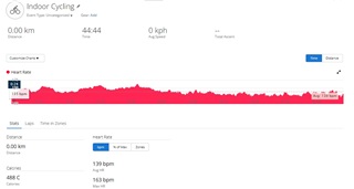

To further illustrate, the pictures below are two activities on the same bike, but one from the vivo last week and the other the fenix this week, with the fenix saying it was 33 calories in 20 min. Any help would be appreciated.
