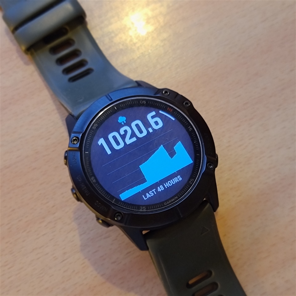

What's causing this weird looking pressure graph? I didn't change location and it goes further back than this.
FW 19.74...I kind of suspect this, but I dunno.
Ideas?
Ideas?

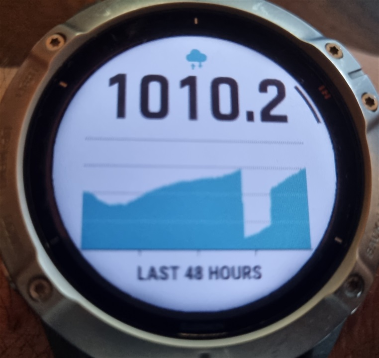

OK, then at least there's two of us, in this misery . Let's hope for a fix soon.
Since you’re on beta software you need to contact Garmin as directed. You could also load 19.75b and see if that makes any difference.
Same for me. Also noticed that the altimeter gone mad and showd a couple of hundreds meters to high altitude. The graph is from 19.74 BETA so i dont know if the same problem exists in 19.75 BETA.
OK, installing 19.75b now - hopefully the remedy required,
I believe it's a 19.74 behavior caused by the baro automatic calibration at night turned on.
The weather.
I guess you guys live in europe and there were some stormy days and the pressure has droped accordingly as can be seen here

I observed the same behaviour last thursday (storm over central europe), the pressure increase in the graph was definitely triggered by the passing of the cold front when atmospheric pressure dropped by a few mbar within minutes, probably fluctuating quite a bit in that time. No surprise that the fenix attributed the quick pressure changes to altitude changes instead of weather: I "climbed" 180 m up (while I was sound asleep).
I'm also on the current beta (19.74 in the screenshot, now 19.75), but I did (and do) not consider this a beta problem but a general, probably unresolvable issue of the auto baro-/altimeter mode in such extreme weather conditions.
I have similar on my F6 but I did move inland and up from sea level to ~400m. My thinking to is that this shows the barometer correcting itself but could of course be proved wrong. I'm waiting to see if similar occurs when I return to sea level on Tuesday.
Sometimes if you sink the watch in the water or just by washing your hands it can affect the barometer.
To make sure that is not something caused by the user just leave the watch on a table for 48 hours and see what will happen
