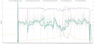

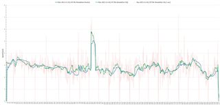

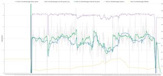

I've noticed a persistent issue in the last couple of weeks. I didn't, unfortunately, notice when my software updated to version 19.20, so I can't say for sure that this is just related to the recent software update. My instantaneous pace during runs looks pretty steady, but it will be persistently low for long portions of runs. For example, today during an easy trail run (flat terrain) I watched my instantaneous pace during a full kilometer of running at about 5 min/km pace. The whole time, the watch showed my pace between 5:40 and 6:30, which is implausibly slow. When the auto lap completed for that kilometer, however, it showed a lap pace of 4:55.
In the past, the instantaneous pace would only be that far off when I had a GPS issue, and it would usually overcorrect in the other direction when trying to correct my location. Now, there is nothing wrong with my recorded GPS track, and the lap paces all come out fine, so I am guessing this is a result of a heavyhanded attempt at quieting the occasional spikes in instantaneous pace that used to occur. Has anyone else noticed this recently, or is it possible there's just something wrong with my watch?
