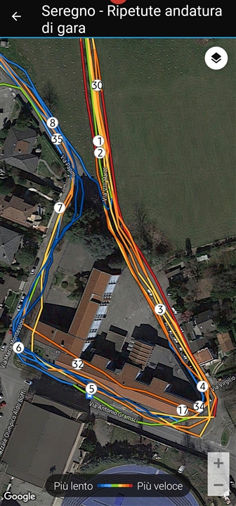

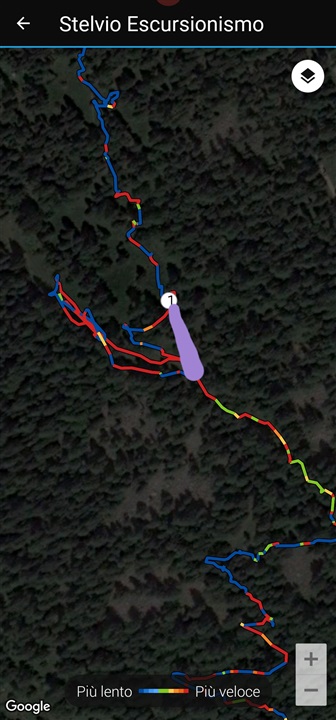

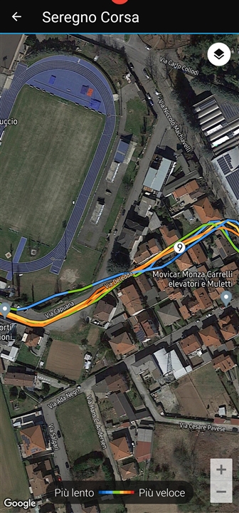

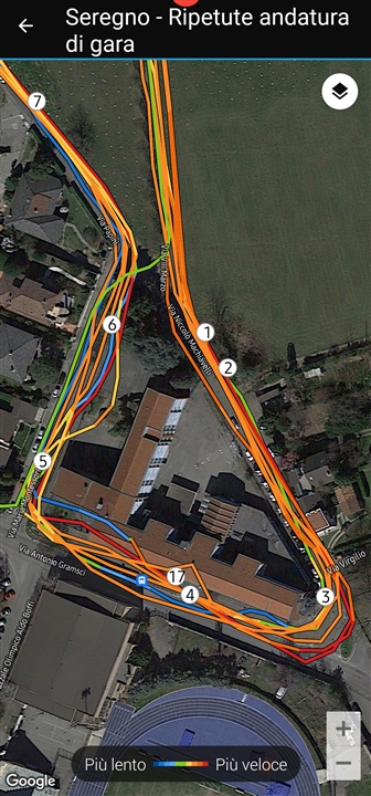

I still have both "issues", zig zags when running in between buildings and the opposite, a "straight" line when zig-zaging in the dense forest. In this case, the track is shortened...
In any case, "business as usual"...nothing special on the Fenix 6 per se...

I think I do understand your issue. The problem is: GPS is for location determination. And it has a "resolution" of 5m or so. So when you take the "raw" GPS data, you may move even when standing still. Or move for a zick zack line of 10 meters when you actually just did 3 steps to the side. You cannot get reliable pace information. There are "filters" to improve this. Some are better, some are worse. It is a pitty that you have a watch which doesn't meet your requirements.
