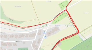

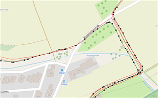

  • I changed the settings and did another run yesterday wearing both watches. Now the results are absolutely comparable. The track length is similar. There are areas where the Vertix2 (red) looks better:
    ... and there are areas where it is the other way around:
    Both tracks look similar. Sometimes, there is some "distance" in between them but never more than 10 meters or so. So at least my 6X is "good enough", I guess.
