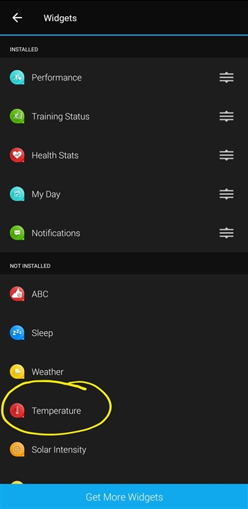

  • What is the name of the temperature widget and where to download it?
    If possible, give a link to the page or download it.
    Thank you.
  • It comes with the watch. You should be able to scroll to it if it is already installed, or install it from the watch or from Garmin Connect Mobile.
