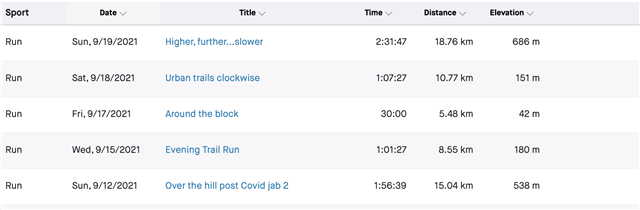

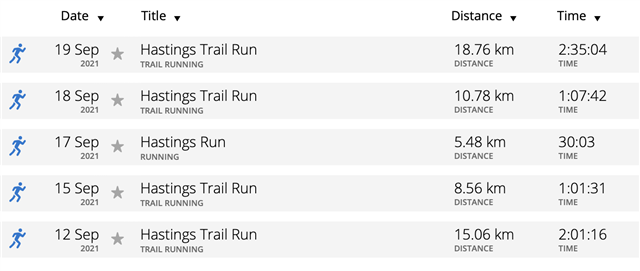

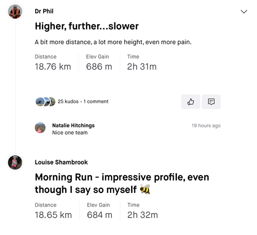

  • I do have a reasonable amount of comparison data using two watches but I also have data from my wife's 945 or Instinct when we run together. I can say, hand on heart, that there is little to tell in the distance recorded between the two. This for example from a lumpy trail run yesterday
    I can show similar for road runs too. So, while I have no doubt that some see problems, my experience is to the contrary. yes there are difference, but they are generally not significant differences.
